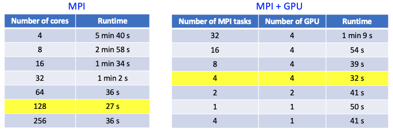

I managed to pass the following options to PETSc using a GPU node on Perlmutter. -mat_type aijcusparse -vec_type cuda -log_view -options_left Below is a summary of the test using 4 MPI tasks and 1 GPU per task. o #PETSc Option Table entries: -log_view -mat_type aijcusparse -options_left -vec_type cuda #End of PETSc Option Table entries WARNING! There are options you set that were not used! WARNING! could be spelling mistake, etc! There is one unused database option. It is: Option left: name:-mat_type value: aijcusparse The -mat_type option has not been used. In the application code, we use ierr = MatCreateAIJ(PETSC_COMM_WORLD,mlocal,mlocal,m,n, d_nz,PETSC_NULL,o_nz,PETSC_NULL,&A);;CHKERRQ(ierr); o The percent flops on the GPU for KSPSolve is 17%. In comparison with a CPU run using 16 MPI tasks, the GPU run is an order of magnitude slower. How can I improve the GPU performance? Thanks, Cho ________________________________ From: Ng, Cho-Kuen <[email protected]> Sent: Friday, June 30, 2023 7:57 AM To: Barry Smith <[email protected]>; Mark Adams <[email protected]> Cc: Matthew Knepley <[email protected]>; [email protected] <[email protected]> Subject: Re: [petsc-users] Using PETSc GPU backend Barry, Mark and Matt, Thank you all for the suggestions. I will modify the code so we can pass runtime options. Cho ________________________________ From: Barry Smith <[email protected]> Sent: Friday, June 30, 2023 7:01 AM To: Mark Adams <[email protected]> Cc: Matthew Knepley <[email protected]>; Ng, Cho-Kuen <[email protected]>; [email protected] <[email protected]> Subject: Re: [petsc-users] Using PETSc GPU backend Note that options like -mat_type aijcusparse -vec_type cuda only work if the program is set up to allow runtime swapping of matrix and vector types. If you have a call to MatCreateMPIAIJ() or other specific types then then these options do nothing but because Mark had you use -options_left the program will tell you at the end that it did not use the option so you will know. On Jun 30, 2023, at 9:30 AM, Mark Adams <[email protected]> wrote: PetscCall(PetscInitialize(&argc, &argv, NULL, help)); gives us the args and you run: a.out -mat_type aijcusparse -vec_type cuda -log_view -options_left Mark On Fri, Jun 30, 2023 at 6:16 AM Matthew Knepley <[email protected]<mailto:[email protected]>> wrote: On Fri, Jun 30, 2023 at 1:13 AM Ng, Cho-Kuen via petsc-users <[email protected]<mailto:[email protected]>> wrote: Mark, The application code reads in parameters from an input file, where we can put the PETSc runtime options. Then we pass the options to PetscInitialize(...). Does that sounds right? PETSc will read command line argument automatically in PetscInitialize() unless you shut it off. Thanks, Matt Cho ________________________________ From: Ng, Cho-Kuen <[email protected]<mailto:[email protected]>> Sent: Thursday, June 29, 2023 8:32 PM To: Mark Adams <[email protected]<mailto:[email protected]>> Cc: [email protected]<mailto:[email protected]> <[email protected]<mailto:[email protected]>> Subject: Re: [petsc-users] Using PETSc GPU backend Mark, Thanks for the information. How do I put the runtime options for the executable, say, a.out, which does not have the provision to append arguments? Do I need to change the C++ main to read in the options? Cho ________________________________ From: Mark Adams <[email protected]<mailto:[email protected]>> Sent: Thursday, June 29, 2023 5:55 PM To: Ng, Cho-Kuen <[email protected]<mailto:[email protected]>> Cc: [email protected]<mailto:[email protected]> <[email protected]<mailto:[email protected]>> Subject: Re: [petsc-users] Using PETSc GPU backend Run with options: -mat_type aijcusparse -vec_type cuda -log_view -options_left The last column of the performance data (from -log_view) will be the percent flops on the GPU. Check that that is > 0. The end of the output will list the options that were used and options that were _not_ used (if any). Check that there are no options left. Mark On Thu, Jun 29, 2023 at 7:50 PM Ng, Cho-Kuen via petsc-users <[email protected]<mailto:[email protected]>> wrote: I installed PETSc on Perlmutter using "spack install petsc+cuda+zoltan" and used it by "spack load petsc/fwge6pf". Then I compiled the application code (purely CPU code) linking to the petsc package, hoping that I can get performance improvement using the petsc GPU backend. However, the timing was the same using the same number of MPI tasks with and without GPU accelerators. Have I missed something in the process, for example, setting up PETSc options at runtime to use the GPU backend? Thanks, Cho -- What most experimenters take for granted before they begin their experiments is infinitely more interesting than any results to which their experiments lead. -- Norbert Wiener https://www.cse.buffalo.edu/~knepley/<http://www.cse.buffalo.edu/~knepley/>
If you create the Mat this way, then you need MatSetFromOptions() in order to set the type from the command line. Thanks, Matt

Barry and Matt, Thanks for your help. Now I can use petsc GPU backend on Perlmutter: 1 node, 4 MPI tasks and 4 GPUs. However, I ran into problems with multiple nodes: 2 nodes, 8 MPI tasks and 8 GPUs. The run hung on KSPSolve. How can I fix this? Best, Cho ________________________________ From: Barry Smith <[email protected]> Sent: Monday, July 17, 2023 6:58 AM To: Ng, Cho-Kuen <[email protected]> Cc: [email protected] <[email protected]> Subject: Re: [petsc-users] Using PETSc GPU backend The examples that use DM, in particular DMDA all trivially support using the GPU with -dm_mat_type aijcusparse -dm_vec_type cuda On Jul 17, 2023, at 1:45 AM, Ng, Cho-Kuen <[email protected]> wrote: Barry, Thank you so much for the clarification. I see that ex104.c and ex300.c use MatXAIJSetPreallocation(). Are there other tutorials available? Cho ________________________________ From: Barry Smith <[email protected]<mailto:[email protected]>> Sent: Saturday, July 15, 2023 8:36 AM To: Ng, Cho-Kuen <[email protected]<mailto:[email protected]>> Cc: [email protected]<mailto:[email protected]> <[email protected]<mailto:[email protected]>> Subject: Re: [petsc-users] Using PETSc GPU backend Cho, We currently have a crappy API for turning on GPU support, and our documentation is misleading in places. People constantly say "to use GPU's with PETSc you only need to use -mat_type aijcusparse (for example)" This is incorrect. This does not work with code that uses the convenience Mat constructors such as MatCreateAIJ(), MatCreateAIJWithArrays etc. It only works if you use the constructor approach of MatCreate(), MatSetSizes(), MatSetFromOptions(), MatXXXSetPreallocation(). ... Similarly you need to use VecCreate(), VecSetSizes(), VecSetFromOptions() and -vec_type cuda If you use DM to create the matrices and vectors then you can use -dm_mat_type aijcusparse -dm_vec_type cuda Sorry for the confusion. Barry On Jul 15, 2023, at 8:03 AM, Matthew Knepley <[email protected]<mailto:[email protected]>> wrote: On Sat, Jul 15, 2023 at 1:44 AM Ng, Cho-Kuen <[email protected]<mailto:[email protected]>> wrote: Matt, After inserting 2 lines in the code: ierr = MatCreate(PETSC_COMM_WORLD,&A);CHKERRQ(ierr); ierr = MatSetFromOptions(A);CHKERRQ(ierr); ierr = MatCreateAIJ(PETSC_COMM_WORLD,mlocal,mlocal,m,n, d_nz,PETSC_NULL,o_nz,PETSC_NULL,&A);;CHKERRQ(ierr); "There are no unused options." However, there is no improvement on the GPU performance. 1. MatCreateAIJ() sets the type, and in fact it overwrites the Mat you created in steps 1 and 2. This is detailed in the manual. 2. You should replace MatCreateAIJ(), with MatSetSizes() before MatSetFromOptions(). THanks, Matt Thanks, Cho ________________________________ From: Matthew Knepley <[email protected]<mailto:[email protected]>> Sent: Friday, July 14, 2023 5:57 PM To: Ng, Cho-Kuen <[email protected]<mailto:[email protected]>> Cc: Barry Smith <[email protected]<mailto:[email protected]>>; Mark Adams <[email protected]<mailto:[email protected]>>; [email protected]<mailto:[email protected]> <[email protected]<mailto:[email protected]>> Subject: Re: [petsc-users] Using PETSc GPU backend On Fri, Jul 14, 2023 at 7:57 PM Ng, Cho-Kuen <[email protected]<mailto:[email protected]>> wrote: I managed to pass the following options to PETSc using a GPU node on Perlmutter. -mat_type aijcusparse -vec_type cuda -log_view -options_left Below is a summary of the test using 4 MPI tasks and 1 GPU per task. o #PETSc Option Table entries: -log_view -mat_type aijcusparse -options_left -vec_type cuda #End of PETSc Option Table entries WARNING! There are options you set that were not used! WARNING! could be spelling mistake, etc! There is one unused database option. It is: Option left: name:-mat_type value: aijcusparse The -mat_type option has not been used. In the application code, we use ierr = MatCreateAIJ(PETSC_COMM_WORLD,mlocal,mlocal,m,n, d_nz,PETSC_NULL,o_nz,PETSC_NULL,&A);;CHKERRQ(ierr); If you create the Mat this way, then you need MatSetFromOptions() in order to set the type from the command line. Thanks, Matt o The percent flops on the GPU for KSPSolve is 17%. In comparison with a CPU run using 16 MPI tasks, the GPU run is an order of magnitude slower. How can I improve the GPU performance? Thanks, Cho ________________________________ From: Ng, Cho-Kuen <[email protected]<mailto:[email protected]>> Sent: Friday, June 30, 2023 7:57 AM To: Barry Smith <[email protected]<mailto:[email protected]>>; Mark Adams <[email protected]<mailto:[email protected]>> Cc: Matthew Knepley <[email protected]<mailto:[email protected]>>; [email protected]<mailto:[email protected]> <[email protected]<mailto:[email protected]>> Subject: Re: [petsc-users] Using PETSc GPU backend Barry, Mark and Matt, Thank you all for the suggestions. I will modify the code so we can pass runtime options. Cho ________________________________ From: Barry Smith <[email protected]<mailto:[email protected]>> Sent: Friday, June 30, 2023 7:01 AM To: Mark Adams <[email protected]<mailto:[email protected]>> Cc: Matthew Knepley <[email protected]<mailto:[email protected]>>; Ng, Cho-Kuen <[email protected]<mailto:[email protected]>>; [email protected]<mailto:[email protected]> <[email protected]<mailto:[email protected]>> Subject: Re: [petsc-users] Using PETSc GPU backend Note that options like -mat_type aijcusparse -vec_type cuda only work if the program is set up to allow runtime swapping of matrix and vector types. If you have a call to MatCreateMPIAIJ() or other specific types then then these options do nothing but because Mark had you use -options_left the program will tell you at the end that it did not use the option so you will know. On Jun 30, 2023, at 9:30 AM, Mark Adams <[email protected]<mailto:[email protected]>> wrote: PetscCall(PetscInitialize(&argc, &argv, NULL, help)); gives us the args and you run: a.out -mat_type aijcusparse -vec_type cuda -log_view -options_left Mark On Fri, Jun 30, 2023 at 6:16 AM Matthew Knepley <[email protected]<mailto:[email protected]>> wrote: On Fri, Jun 30, 2023 at 1:13 AM Ng, Cho-Kuen via petsc-users <[email protected]<mailto:[email protected]>> wrote: Mark, The application code reads in parameters from an input file, where we can put the PETSc runtime options. Then we pass the options to PetscInitialize(...). Does that sounds right? PETSc will read command line argument automatically in PetscInitialize() unless you shut it off. Thanks, Matt Cho ________________________________ From: Ng, Cho-Kuen <[email protected]<mailto:[email protected]>> Sent: Thursday, June 29, 2023 8:32 PM To: Mark Adams <[email protected]<mailto:[email protected]>> Cc: [email protected]<mailto:[email protected]> <[email protected]<mailto:[email protected]>> Subject: Re: [petsc-users] Using PETSc GPU backend Mark, Thanks for the information. How do I put the runtime options for the executable, say, a.out, which does not have the provision to append arguments? Do I need to change the C++ main to read in the options? Cho ________________________________ From: Mark Adams <[email protected]<mailto:[email protected]>> Sent: Thursday, June 29, 2023 5:55 PM To: Ng, Cho-Kuen <[email protected]<mailto:[email protected]>> Cc: [email protected]<mailto:[email protected]> <[email protected]<mailto:[email protected]>> Subject: Re: [petsc-users] Using PETSc GPU backend Run with options: -mat_type aijcusparse -vec_type cuda -log_view -options_left The last column of the performance data (from -log_view) will be the percent flops on the GPU. Check that that is > 0. The end of the output will list the options that were used and options that were _not_ used (if any). Check that there are no options left. Mark On Thu, Jun 29, 2023 at 7:50 PM Ng, Cho-Kuen via petsc-users <[email protected]<mailto:[email protected]>> wrote: I installed PETSc on Perlmutter using "spack install petsc+cuda+zoltan" and used it by "spack load petsc/fwge6pf". Then I compiled the application code (purely CPU code) linking to the petsc package, hoping that I can get performance improvement using the petsc GPU backend. However, the timing was the same using the same number of MPI tasks with and without GPU accelerators. Have I missed something in the process, for example, setting up PETSc options at runtime to use the GPU backend? Thanks, Cho -- What most experimenters take for granted before they begin their experiments is infinitely more interesting than any results to which their experiments lead. -- Norbert Wiener https://www.cse.buffalo.edu/~knepley/<http://www.cse.buffalo.edu/~knepley/> -- What most experimenters take for granted before they begin their experiments is infinitely more interesting than any results to which their experiments lead. -- Norbert Wiener https://www.cse.buffalo.edu/~knepley/<http://www.cse.buffalo.edu/~knepley/> -- What most experimenters take for granted before they begin their experiments is infinitely more interesting than any results to which their experiments lead. -- Norbert Wiener https://www.cse.buffalo.edu/~knepley/<http://www.cse.buffalo.edu/~knepley/> ________________________________ From: Barry Smith <[email protected]> Sent: Monday, July 17, 2023 6:58 AM To: Ng, Cho-Kuen <[email protected]> Cc: [email protected] <[email protected]> Subject: Re: [petsc-users] Using PETSc GPU backend The examples that use DM, in particular DMDA all trivially support using the GPU with -dm_mat_type aijcusparse -dm_vec_type cuda On Jul 17, 2023, at 1:45 AM, Ng, Cho-Kuen <[email protected]> wrote: Barry, Thank you so much for the clarification. I see that ex104.c and ex300.c use MatXAIJSetPreallocation(). Are there other tutorials available? Cho ________________________________ From: Barry Smith <[email protected]<mailto:[email protected]>> Sent: Saturday, July 15, 2023 8:36 AM To: Ng, Cho-Kuen <[email protected]<mailto:[email protected]>> Cc: [email protected]<mailto:[email protected]> <[email protected]<mailto:[email protected]>> Subject: Re: [petsc-users] Using PETSc GPU backend Cho, We currently have a crappy API for turning on GPU support, and our documentation is misleading in places. People constantly say "to use GPU's with PETSc you only need to use -mat_type aijcusparse (for example)" This is incorrect. This does not work with code that uses the convenience Mat constructors such as MatCreateAIJ(), MatCreateAIJWithArrays etc. It only works if you use the constructor approach of MatCreate(), MatSetSizes(), MatSetFromOptions(), MatXXXSetPreallocation(). ... Similarly you need to use VecCreate(), VecSetSizes(), VecSetFromOptions() and -vec_type cuda If you use DM to create the matrices and vectors then you can use -dm_mat_type aijcusparse -dm_vec_type cuda Sorry for the confusion. Barry On Jul 15, 2023, at 8:03 AM, Matthew Knepley <[email protected]<mailto:[email protected]>> wrote: On Sat, Jul 15, 2023 at 1:44 AM Ng, Cho-Kuen <[email protected]<mailto:[email protected]>> wrote: Matt, After inserting 2 lines in the code: ierr = MatCreate(PETSC_COMM_WORLD,&A);CHKERRQ(ierr); ierr = MatSetFromOptions(A);CHKERRQ(ierr); ierr = MatCreateAIJ(PETSC_COMM_WORLD,mlocal,mlocal,m,n, d_nz,PETSC_NULL,o_nz,PETSC_NULL,&A);;CHKERRQ(ierr); "There are no unused options." However, there is no improvement on the GPU performance. 1. MatCreateAIJ() sets the type, and in fact it overwrites the Mat you created in steps 1 and 2. This is detailed in the manual. 2. You should replace MatCreateAIJ(), with MatSetSizes() before MatSetFromOptions(). THanks, Matt Thanks, Cho ________________________________ From: Matthew Knepley <[email protected]<mailto:[email protected]>> Sent: Friday, July 14, 2023 5:57 PM To: Ng, Cho-Kuen <[email protected]<mailto:[email protected]>> Cc: Barry Smith <[email protected]<mailto:[email protected]>>; Mark Adams <[email protected]<mailto:[email protected]>>; [email protected]<mailto:[email protected]> <[email protected]<mailto:[email protected]>> Subject: Re: [petsc-users] Using PETSc GPU backend On Fri, Jul 14, 2023 at 7:57 PM Ng, Cho-Kuen <[email protected]<mailto:[email protected]>> wrote: I managed to pass the following options to PETSc using a GPU node on Perlmutter. -mat_type aijcusparse -vec_type cuda -log_view -options_left Below is a summary of the test using 4 MPI tasks and 1 GPU per task. o #PETSc Option Table entries: -log_view -mat_type aijcusparse -options_left -vec_type cuda #End of PETSc Option Table entries WARNING! There are options you set that were not used! WARNING! could be spelling mistake, etc! There is one unused database option. It is: Option left: name:-mat_type value: aijcusparse The -mat_type option has not been used. In the application code, we use ierr = MatCreateAIJ(PETSC_COMM_WORLD,mlocal,mlocal,m,n, d_nz,PETSC_NULL,o_nz,PETSC_NULL,&A);;CHKERRQ(ierr); If you create the Mat this way, then you need MatSetFromOptions() in order to set the type from the command line. Thanks, Matt o The percent flops on the GPU for KSPSolve is 17%. In comparison with a CPU run using 16 MPI tasks, the GPU run is an order of magnitude slower. How can I improve the GPU performance? Thanks, Cho ________________________________ From: Ng, Cho-Kuen <[email protected]<mailto:[email protected]>> Sent: Friday, June 30, 2023 7:57 AM To: Barry Smith <[email protected]<mailto:[email protected]>>; Mark Adams <[email protected]<mailto:[email protected]>> Cc: Matthew Knepley <[email protected]<mailto:[email protected]>>; [email protected]<mailto:[email protected]> <[email protected]<mailto:[email protected]>> Subject: Re: [petsc-users] Using PETSc GPU backend Barry, Mark and Matt, Thank you all for the suggestions. I will modify the code so we can pass runtime options. Cho ________________________________ From: Barry Smith <[email protected]<mailto:[email protected]>> Sent: Friday, June 30, 2023 7:01 AM To: Mark Adams <[email protected]<mailto:[email protected]>> Cc: Matthew Knepley <[email protected]<mailto:[email protected]>>; Ng, Cho-Kuen <[email protected]<mailto:[email protected]>>; [email protected]<mailto:[email protected]> <[email protected]<mailto:[email protected]>> Subject: Re: [petsc-users] Using PETSc GPU backend Note that options like -mat_type aijcusparse -vec_type cuda only work if the program is set up to allow runtime swapping of matrix and vector types. If you have a call to MatCreateMPIAIJ() or other specific types then then these options do nothing but because Mark had you use -options_left the program will tell you at the end that it did not use the option so you will know. On Jun 30, 2023, at 9:30 AM, Mark Adams <[email protected]<mailto:[email protected]>> wrote: PetscCall(PetscInitialize(&argc, &argv, NULL, help)); gives us the args and you run: a.out -mat_type aijcusparse -vec_type cuda -log_view -options_left Mark On Fri, Jun 30, 2023 at 6:16 AM Matthew Knepley <[email protected]<mailto:[email protected]>> wrote: On Fri, Jun 30, 2023 at 1:13 AM Ng, Cho-Kuen via petsc-users <[email protected]<mailto:[email protected]>> wrote: Mark, The application code reads in parameters from an input file, where we can put the PETSc runtime options. Then we pass the options to PetscInitialize(...). Does that sounds right? PETSc will read command line argument automatically in PetscInitialize() unless you shut it off. Thanks, Matt Cho ________________________________ From: Ng, Cho-Kuen <[email protected]<mailto:[email protected]>> Sent: Thursday, June 29, 2023 8:32 PM To: Mark Adams <[email protected]<mailto:[email protected]>> Cc: [email protected]<mailto:[email protected]> <[email protected]<mailto:[email protected]>> Subject: Re: [petsc-users] Using PETSc GPU backend Mark, Thanks for the information. How do I put the runtime options for the executable, say, a.out, which does not have the provision to append arguments? Do I need to change the C++ main to read in the options? Cho ________________________________ From: Mark Adams <[email protected]<mailto:[email protected]>> Sent: Thursday, June 29, 2023 5:55 PM To: Ng, Cho-Kuen <[email protected]<mailto:[email protected]>> Cc: [email protected]<mailto:[email protected]> <[email protected]<mailto:[email protected]>> Subject: Re: [petsc-users] Using PETSc GPU backend Run with options: -mat_type aijcusparse -vec_type cuda -log_view -options_left The last column of the performance data (from -log_view) will be the percent flops on the GPU. Check that that is > 0. The end of the output will list the options that were used and options that were _not_ used (if any). Check that there are no options left. Mark On Thu, Jun 29, 2023 at 7:50 PM Ng, Cho-Kuen via petsc-users <[email protected]<mailto:[email protected]>> wrote: I installed PETSc on Perlmutter using "spack install petsc+cuda+zoltan" and used it by "spack load petsc/fwge6pf". Then I compiled the application code (purely CPU code) linking to the petsc package, hoping that I can get performance improvement using the petsc GPU backend. However, the timing was the same using the same number of MPI tasks with and without GPU accelerators. Have I missed something in the process, for example, setting up PETSc options at runtime to use the GPU backend? Thanks, Cho -- What most experimenters take for granted before they begin their experiments is infinitely more interesting than any results to which their experiments lead. -- Norbert Wiener https://www.cse.buffalo.edu/~knepley/<http://www.cse.buffalo.edu/~knepley/> -- What most experimenters take for granted before they begin their experiments is infinitely more interesting than any results to which their experiments lead. -- Norbert Wiener https://www.cse.buffalo.edu/~knepley/<http://www.cse.buffalo.edu/~knepley/> -- What most experimenters take for granted before they begin their experiments is infinitely more interesting than any results to which their experiments lead. -- Norbert Wiener https://www.cse.buffalo.edu/~knepley/<http://www.cse.buffalo.edu/~knepley/>
We would need more information about "hanging". Do PETSc examples and tiny problems "hang" on multiple nodes? If you run with -info what are the last messages printed? Can you run with a debugger to see where it is "hanging"?
On Aug 9, 2023, at 5:59 PM, Ng, Cho-Kuen <[email protected]> wrote:
Barry and Matt,
Best, Cho
Best, Cho

I performed tests on comparison using KSP with and without cuda backend on NERSC's Perlmutter. For a finite element solve with 800k degrees of freedom, the best times obtained using MPI and MPI+GPU were o MPI - 128 MPI tasks, 27 s o MPI+GPU - 4 MPI tasks, 4 GPU's, 32 s Is that the performance one would expect using the hybrid mode of computation. Attached image shows the scaling on a single node. Thanks, Cho ________________________________ From: Ng, Cho-Kuen <[email protected]> Sent: Saturday, August 12, 2023 8:08 AM To: Jacob Faibussowitsch <[email protected]> Cc: Barry Smith <[email protected]>; petsc-users <[email protected]> Subject: Re: [petsc-users] Using PETSc GPU backend Thanks Jacob. ________________________________ From: Jacob Faibussowitsch <[email protected]> Sent: Saturday, August 12, 2023 5:02 AM To: Ng, Cho-Kuen <[email protected]> Cc: Barry Smith <[email protected]>; petsc-users <[email protected]> Subject: Re: [petsc-users] Using PETSc GPU backend
Can petsc show the number of GPUs used?
-device_view Best regards, Jacob Faibussowitsch (Jacob Fai - booss - oh - vitch)

I tried again today on Perlmutter and running on multiple GPU nodes worked. Likely, I had messed up something the other day. Also, I was able to have multiple MPI tasks on a GPU using Nvidia MPS. The petsc output shows the number of MPI tasks:
KSP Object: 32 MPI processes
Thanks, Cho

800k is a pretty small problem for GPUs. We would need to see the runs with output from -ksp_view -log_view to see if the timing results are reasonable.

<Untitled.png>
Barry, Attached is the petsc output. Thanks, Cho ________________________________ From: Barry Smith <[email protected]> Sent: Friday, April 12, 2024 12:53 PM To: Ng, Cho-Kuen <[email protected]> Cc: Jacob Faibussowitsch <[email protected]>; petsc-users <[email protected]> Subject: Re: [petsc-users] Using PETSc GPU backend 800k is a pretty small problem for GPUs. We would need to see the runs with output from -ksp_view -log_view to see if the timing results are reasonable. On Apr 12, 2024, at 1:48 PM, Ng, Cho-Kuen <[email protected]> wrote: I performed tests on comparison using KSP with and without cuda backend on NERSC's Perlmutter. For a finite element solve with 800k degrees of freedom, the best times obtained using MPI and MPI+GPU were o MPI - 128 MPI tasks, 27 s o MPI+GPU - 4 MPI tasks, 4 GPU's, 32 s Is that the performance one would expect using the hybrid mode of computation. Attached image shows the scaling on a single node. Thanks, Cho ________________________________ From: Ng, Cho-Kuen <[email protected]<mailto:[email protected]>> Sent: Saturday, August 12, 2023 8:08 AM To: Jacob Faibussowitsch <[email protected]<mailto:[email protected]>> Cc: Barry Smith <[email protected]<mailto:[email protected]>>; petsc-users <[email protected]<mailto:[email protected]>> Subject: Re: [petsc-users] Using PETSc GPU backend Thanks Jacob. ________________________________ From: Jacob Faibussowitsch <[email protected]<mailto:[email protected]>> Sent: Saturday, August 12, 2023 5:02 AM To: Ng, Cho-Kuen <[email protected]<mailto:[email protected]>> Cc: Barry Smith <[email protected]<mailto:[email protected]>>; petsc-users <[email protected]<mailto:[email protected]>> Subject: Re: [petsc-users] Using PETSc GPU backend

<Untitled.png>
As Barry said, this is a bit small but the performance looks reasonable. The solver does very badly, mathematically. I would try hypre to get another data point. You could also try 'cg' to check that the pipelined version is not a problem. Mark On Fri, Apr 12, 2024 at 3:54 PM Barry Smith <[email protected]> wrote:
800k is a pretty small problem for GPUs. We would need to see the runs with output from -ksp_view -log_view to see if the timing results are reasonable. On Apr 12, 2024, at 1: 48 PM, Ng, Cho-Kuen <cho@ slac. stanford. edu> wrote: I performed ZjQcmQRYFpfptBannerStart This Message Is From an External Sender This message came from outside your organization.
ZjQcmQRYFpfptBannerEnd

<Untitled.png>
Mark. The FEM problem is of high-frequency Helmholtz type for the Maxwell equation. The combination "-ksp_type groppcg -pc_type gamg" worked for this small problem and the results agreed well with those obtained from the direct solver MUMPS. However, this ksp-pc combination failed to converge for much larger problem sizes. What would be a good combination to solve this kind of large-scale problems where direct solvers would not be able to solve? Thanks, Cho ________________________________ From: Mark Adams <[email protected]> Sent: Friday, April 12, 2024 4:52 PM To: Barry Smith <[email protected]> Cc: Ng, Cho-Kuen <[email protected]>; petsc-users <[email protected]>; Jacob Faibussowitsch <[email protected]> Subject: Re: [petsc-users] Using PETSc GPU backend As Barry said, this is a bit small but the performance looks reasonable. The solver does very badly, mathematically. I would try hypre to get another data point. You could also try 'cg' to check that the pipelined version is not a problem. Mark On Fri, Apr 12, 2024 at 3:54 PM Barry Smith <[email protected]<mailto:[email protected]>> wrote: 800k is a pretty small problem for GPUs. We would need to see the runs with output from -ksp_view -log_view to see if the timing results are reasonable. On Apr 12, 2024, at 1: 48 PM, Ng, Cho-Kuen <cho@ slac. stanford. edu> wrote: I performed ZjQcmQRYFpfptBannerStart This Message Is From an External Sender This message came from outside your organization. ZjQcmQRYFpfptBannerEnd 800k is a pretty small problem for GPUs. We would need to see the runs with output from -ksp_view -log_view to see if the timing results are reasonable. On Apr 12, 2024, at 1:48 PM, Ng, Cho-Kuen <[email protected]<mailto:[email protected]>> wrote: I performed tests on comparison using KSP with and without cuda backend on NERSC's Perlmutter. For a finite element solve with 800k degrees of freedom, the best times obtained using MPI and MPI+GPU were o MPI - 128 MPI tasks, 27 s o MPI+GPU - 4 MPI tasks, 4 GPU's, 32 s Is that the performance one would expect using the hybrid mode of computation. Attached image shows the scaling on a single node. Thanks, Cho ________________________________ From: Ng, Cho-Kuen <[email protected]<mailto:[email protected]>> Sent: Saturday, August 12, 2023 8:08 AM To: Jacob Faibussowitsch <[email protected]<mailto:[email protected]>> Cc: Barry Smith <[email protected]<mailto:[email protected]>>; petsc-users <[email protected]<mailto:[email protected]>> Subject: Re: [petsc-users] Using PETSc GPU backend Thanks Jacob. ________________________________ From: Jacob Faibussowitsch <[email protected]<mailto:[email protected]>> Sent: Saturday, August 12, 2023 5:02 AM To: Ng, Cho-Kuen <[email protected]<mailto:[email protected]>> Cc: Barry Smith <[email protected]<mailto:[email protected]>>; petsc-users <[email protected]<mailto:[email protected]>> Subject: Re: [petsc-users] Using PETSc GPU backend

On Fri, Apr 12, 2024 at 8:19 PM Ng, Cho-Kuen via petsc-users < [email protected]> wrote:
Mark. The FEM problem is of high-frequency Helmholtz type for the Maxwell equation. The combination "-ksp_type groppcg -pc_type gamg" worked for this small problem and the results agreed well with those obtained from the direct solver ZjQcmQRYFpfptBannerStart This Message Is From an External Sender This message came from outside your organization.
ZjQcmQRYFpfptBannerEnd Mark.
Solving high frequency Helmholtz is a hard research problem. There are no easy answers. I know of no real solutions for C0 FEM. it seems to be a bad discretization for this from the start. I have not seen anything reliable that is not mostly direct, but this is not what I do for a living so something might exist, although not in any publicly available software. Thanks, Matt
Thanks, Cho ------------------------------ *From:* Mark Adams <[email protected]> *Sent:* Friday, April 12, 2024 4:52 PM *To:* Barry Smith <[email protected]> *Cc:* Ng, Cho-Kuen <[email protected]>; petsc-users < [email protected]>; Jacob Faibussowitsch <[email protected]> *Subject:* Re: [petsc-users] Using PETSc GPU backend

As Matt said, high- frequency Helmholtz is very hard, low-frequency is doable by using a larger coarse grid (you have a tiny coarse grid). On Sat, Apr 13, 2024 at 3:04 PM Matthew Knepley <[email protected]> wrote:
THanks,
Matt Thanks, Cho

<Untitled.png> -- What most experimenters take for granted before they begin their experiments is infinitely more interesting than any results to which their experiments lead. -- Norbert Wiener https://urldefense.us/v3/__https://www.cse.buffalo.edu/*knepley/__;fg!!G_uCf... <https://urldefense.us/v3/__http://www.cse.buffalo.edu/*knepley/__;fg!!G_uCfs... >
