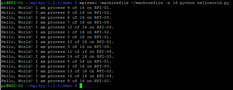

Yes I am sorry I should have added that in the original post. "-n 4 Hostname" prints out the names of my 4 Pis in the cluster and "...-n 16 helloworld.py" prints out as expected as shown in the attached image. So I know that those work correctly. It is just the strangest problem. If I ever specify more than 1 processes it says "you need _ number of processes to run the following tests" even though I have it set to run with said number of processes. Thank you for getting back to me so quickly. This problem is giving me grey hairs and I am only a college student. -Lanze -----Original Message----- From: Kenneth Raffenetti [mailto:[email protected]] Sent: Wednesday, May 27, 2015 8:21 AM To: [email protected] Subject: Re: [mpich-discuss] Running HPL on RPi cluster, seems like MPI is somehow not configured properly since it work with 1 node but not more Please try a simple test to ensure your mpiexec is working correctly. Something like: mpiexec -machinefile ~/machinefile -n 4 hostname That should output the hostnames of the machines you are attempting to run on. Second, you should ensure that the mpiexec and MPI library your program is linked against come from the same distribution. A common error we see is mixing MPICH's mpiexec with Open MPI's library, or vice versa. Ken On 05/26/2015 03:32 PM, Heerdt, Lanze M. wrote:
