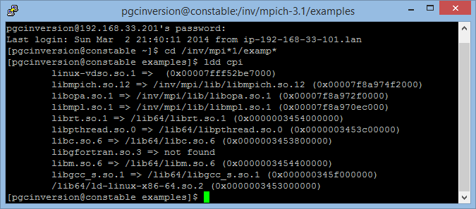

Reuti, thanks for you suggestions... I did the ldd cpi (in the examples directory) on three computers, and I have attached three screenshot. I am using sargeant as the master, where I start these jobs from. Looking at these, I installed gcc-gfortran.x86_64 on the other two computers as well, and they now have identical outputs as the first one (sargeant). Thanks for pointng this out and giving me help in how to check this. I tried: mpiexec -machinefile cluster.txt -np 6 ./cpi were the machine file has only two members, each with 4 cores. I received the same error message as before but that could be for many reasons, and I will now respond to Gus's email with a few clarifications. I appreciate your efforts! R On 3/03/2014 00:28, Reuti wrote:

By runtime libraries, do you mean for the three compilers included, ie gcc, fortran77 and fortran90? Yes. But there should be a package with the runtime libraries, i.e. so that it's not necessary to install the complete compiler suite (I assume in your situation that they are installed, but with different versions). Maybe you can check for older/newer libs in the repository of the distributions.
Which libraries are necessary can be listed by issuing:
$ ldd cpi
on each of the machines and whether they are found.
-- Reuti
NB: With commercial compilers it's for this reason often allowed in the license to give away the runtime libraries (and only these) with your compiled application, as otherwise your customers couldn't run your applications.

I have mpicc the cpi program as suggested by Gus and tried it, as well as the originally provided cpi (part of the downloaded mpi) which I called cpi_orig, see the screen shot below. It looks like there is an issue with libgfortran.so.3... Yep.
Unless you build static applications, the runtime libraries (of the compiler) need to be available on all machines.
There should be package with the runtime libraries in your Linux distribution.
-- Reuti
